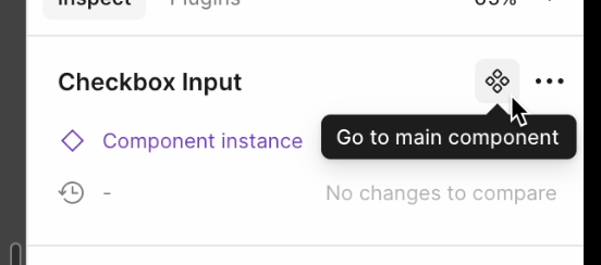

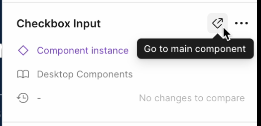

If you have found an instance of a component then there should be an option indicated by either a diamond with four smaller diamonds or a diamond with an arrow pointing out from the diamond. This icon button is used to go to the main component, and will be labelled “Go to main component” once you hover on the icon button. Use this “Go to main component” button to check if there is a component set higher up in the hierarchy. Once you’ve got the main component set, then you can copy a link to the component and move to generating the Code Connect config in your terminal.
Figma user interface showing the "Go to main component" tooltip text when hovering over the diamond icon with four smaller diamonds Figma user interface showing the "Go to main component" tooltip text when hovering over the diamond with an arrowing pointing out from it
